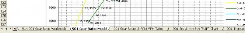

Went to the "914 901 Gear Ratio Workbook" but couldn't find the tabs in that .xls spreadsheet.
Help, where are they hidden? (IMG:style_emoticons/default/wacko.gif)
Nice work pulling all that information together!
race914
post Aug 1 2010, 04:07 PM
73 914-4
Posts: 1,006
Joined: 31-October 05
From: Nipomo, California (Central Coast)
Member No.: 5,027
QUOTE(Randal @ Aug 1 2010, 02:28 PM) *
Hi Randal,
When you open the 914 901 Gear Ration Workbook, open the excel sheet in full screen. Sometimes you won't see the excel tabs (worksheets) on the bottom of the page if not in full screen.
Here's what you should see at the bottom of the excel sheet
Let me know if that works.
Greg
