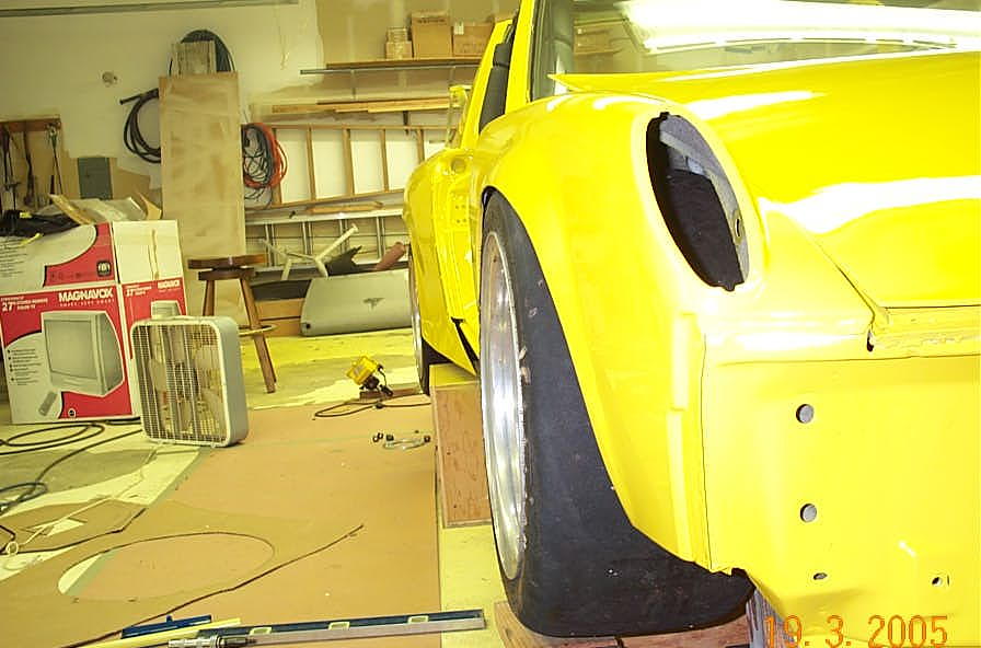

I have never cared for the look of the GT flares (warts), but something is needed for tire clearance.....so.
Asthetics aside. the hand hammered flares cost little but time & 10000 hammer whacks.....each. A bit of pushing & bracing (some dicking around with backspace on the wheel too) on the lower fender got the 10 inch X 16 slicks to fit. No rubbing lock to lock & full suspension compression.
