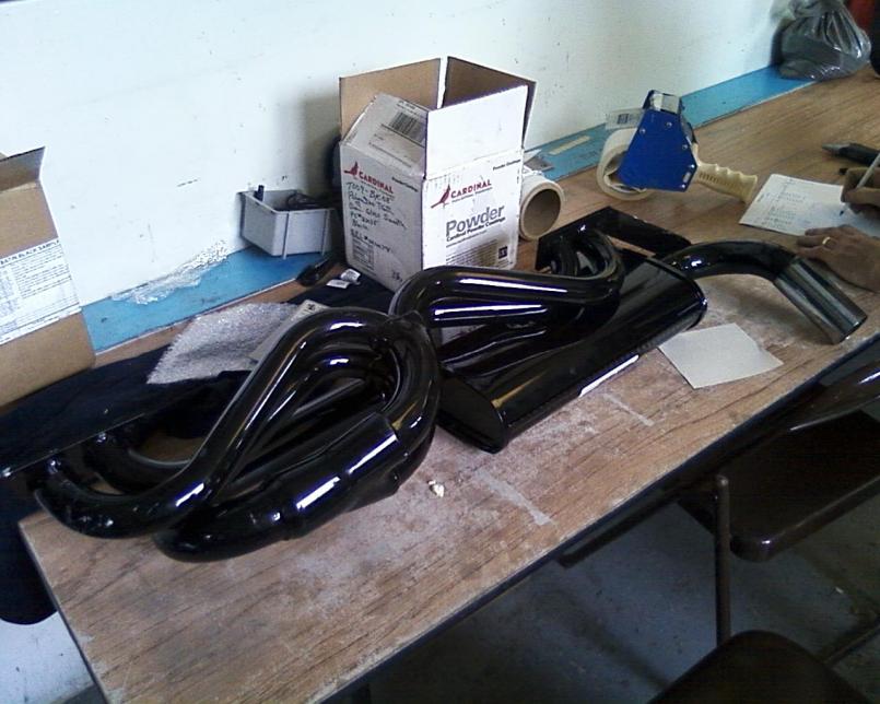

Aug 7 2010, 06:33 PM
#2
Speed Up !!! ![]() ![]() ![]() ![]() Group: Members Posts: 3,210 Joined: 10-February 08 From: Timonium MD 21093 Member No.: 8,696 Region Association: MidAtlantic Region |
I just got my exhaust back from the powdercoater (IMG:style_emoticons/default/cheer.gif)
Sorry i cant get a better picture, today has been very busy, and i only took 1 pic, now i am on my way to the driveway for the install. joe is taking the teener to work sunday morning (IMG:style_emoticons/default/biggrin.gif) here is the brand new bursch, before. It does look pretty in the the picture, but dont let looks fool you (IMG:style_emoticons/default/shades.gif) Attached thumbnail(s) |

jsayre914 here it is powdered and ready..... :beer3: Aug 7 2010, 06:33 PM
Vacca Rabite Looks bitch'n.
Let us know how the high temp ... Aug 7 2010, 08:52 PM

jsayre914 :( Here you go.
This brand new Bursch exhaust f... Aug 9 2010, 09:45 AM

jsayre914 The phone call;
ring ring ring
John my exhaust ... Aug 9 2010, 10:40 AM

jsayre914 So.... :(
I waited another 2 weeks and picked up... Sep 7 2010, 10:01 AM
jsayre914 isnt it beuatiful :wub: :sick: Sep 7 2010, 10:02 AM
Vacca Rabite Joe, take a sharp knife - like an exacto knife - a... Sep 7 2010, 10:51 AM

is the metal actually dented?
Yup! reeee... Sep 7 2010, 12:48 PM
DanT looks like the metal is deformed to me....look at ... Sep 7 2010, 12:18 PM
jsayre914 I just got off the phone with Doug at Horespower E... Sep 7 2010, 02:32 PM
