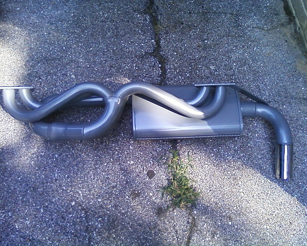

Aug 7 2010, 06:33 PM
#2
Speed Up !!! ![]() ![]() ![]() ![]() Group: Members Posts: 3,210 Joined: 10-February 08 From: Timonium MD 21093 Member No.: 8,696 Region Association: MidAtlantic Region |
here it is powdered and ready..... (IMG:style_emoticons/default/beer3.gif)
