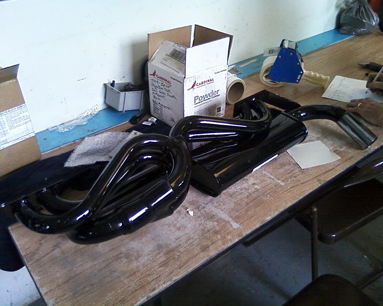

I just got my exhaust back from the powdercoater (IMG:style_emoticons/default/cheer.gif)
Sorry i cant get a better picture, today has been very busy, and i only took 1 pic, now i am on my way to the driveway for the install. joe is taking the teener to work sunday morning (IMG:style_emoticons/default/biggrin.gif) here is the brand new bursch, before. It does look pretty in the the picture, but dont let looks fool you (IMG:style_emoticons/default/shades.gif) Attached thumbnail(s) |

jsayre914 dropped my brand new exhaust off to the local powd... Aug 5 2010, 11:23 AM
Vacca Rabite
dropped my brand new exhaust off to the local pow... Aug 5 2010, 12:44 PM
ONTHEGRIND Sandblast
http://www.914world.com/bbs2/uploads_of... Aug 5 2010, 11:31 AM
jsayre914 They said they have HIGH HEAT powder. and the sele... Aug 5 2010, 01:25 PM
Vacca Rabite Don't be scared. I don't know shit about ... Aug 5 2010, 04:42 PM
jsayre914 here it is powdered and ready..... :beer3: Aug 7 2010, 06:33 PM
