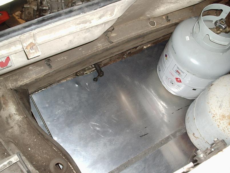

Alum. skin mock up

majkos   Space, perfect for grilling   Aug 11 2010, 09:19 PM
Sleepin   I would think to either make the trunk lid removea...   Aug 11 2010, 09:27 PM
brant   nice looking top in there!   Aug 11 2010, 09:29 PM
majkos   Alum. skin mock up   Aug 11 2010, 09:36 PM
majkos   Plenty of room   Aug 11 2010, 09:38 PM

Sleepin   Seems like every place I read, they say that you w...   Aug 11 2010, 09:48 PM
majkos   Seems like every place I read, they say that you ...   Aug 11 2010, 10:14 PM
Sleepin   Seems like every place I read, they say that you...   Aug 11 2010, 10:25 PM
majkos   600 lbs! dude I don't think it weigh more ...   Aug 11 2010, 10:51 PM
