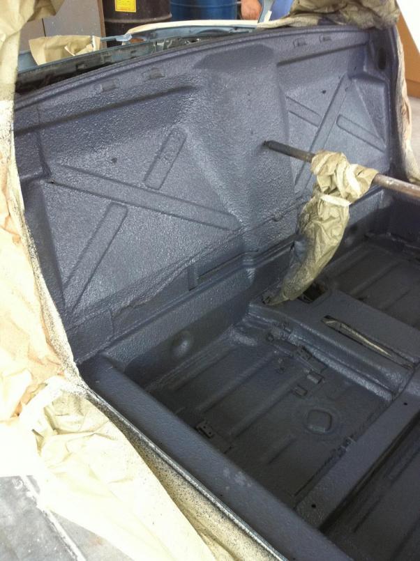

Having recently gone through the whole removal process. I replaced the tar with Lizard Skin
So far I'm very happy with the results. I also had the paint shop spray the entire bottom and fender wells. Sprayed the fire wall with the ceramic coating.

SirAndy   I've been thinking about using a different app...   Oct 10 2010, 05:48 PM
Prospectfarms   I've been thinking about using a different ap...   Nov 1 2011, 08:19 AM
scotty b   You could have saved yourself so much time, aggrav...   Oct 10 2010, 05:54 PM
