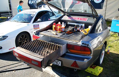

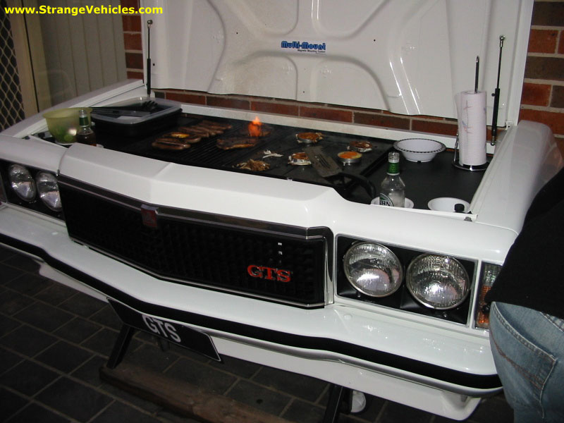

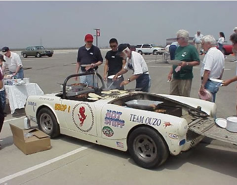

Hey Kevin! We need an update!
(IMG:style_emoticons/default/thisthreadisworthlesswithoutpics.gif)
(IMG:http://www.914world.com/bbs2/uploads_offsite/farm5.static.flickr.com-8357-1282155860.1.jpg)
(IMG:http://www.914world.com/bbs2/uploads_offsite/strangecosmos.com-8357-1282190273.1.jpg)
(IMG:http://www.914world.com/bbs2/uploads_offsite/strangecosmos.com-8357-1282190274.2.jpg)
(IMG:http://www.914world.com/bbs2/uploads_offsite/strangecosmos.com-8357-1282190275.3.jpg)
