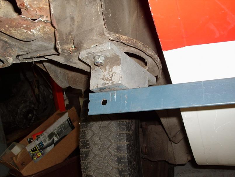

He brought a 2" tube bar,3 'long for the tongue
Anybody have a 2" ball reciever?

rick 918-S   Is that a 2" section of square tube? I may ha...   Aug 11 2010, 08:36 PM

majkos   Rick 2" outside to outside   Aug 11 2010, 08:58 PM
majkos   Rick 2" outside to outside I did :D   Aug 11 2010, 10:15 PM
rick 918-S   Rick 2" outside to outside I did :D PM...   Aug 12 2010, 12:01 AM

majkos   PROGESS!   Sep 4 2010, 02:09 PM
Sleepin   So do you have two more ATS five stars to put on t...   Sep 4 2010, 02:45 PM
majkos   So do you have two more ATS five stars to put on ...   Sep 4 2010, 02:54 PM
