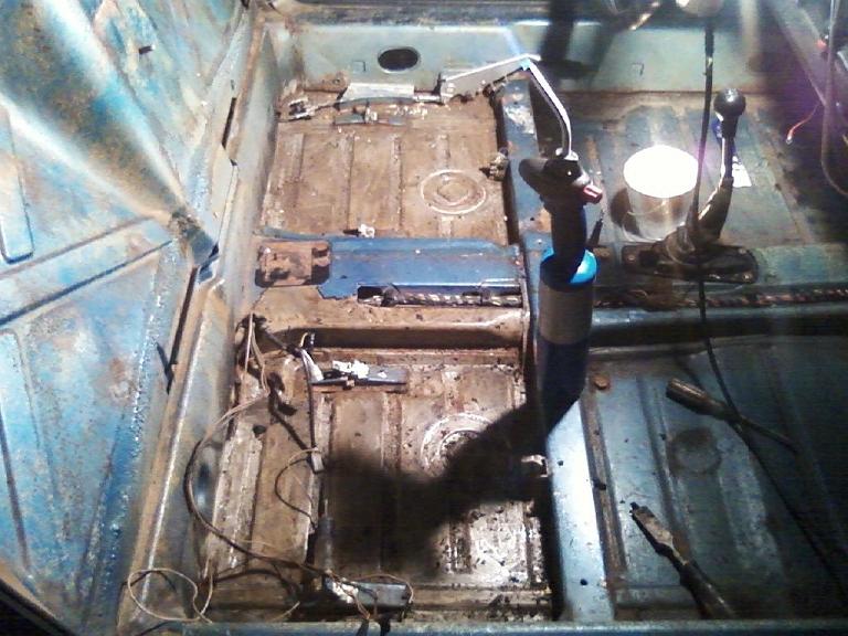

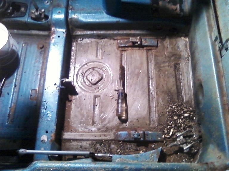

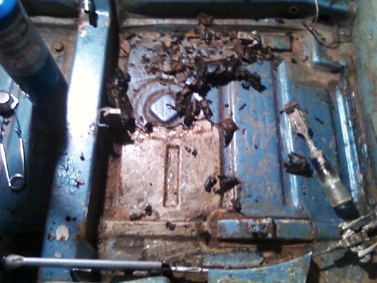

I have been really busy, recently, no time to work. I did get outside last night for a few hours, and BOY WAS IT FUN (IMG:style_emoticons/default/smile.gif) scraping tar with a torch in one hand and a citronella candle to chase off the mesquitos, with my shop light bringing every bug within 2 miles to come see my hard work.
but on the bright side i am halfway untarred (IMG:style_emoticons/default/beerchug.gif) and the fllors look a lot better than i was thinking they would look (IMG:style_emoticons/default/shades.gif)

jsayre914   I didnt get very far, but i started yesterday. I g...   Aug 18 2010, 12:49 PM

McMark   I've used all those products. The Spectrum Sl...   Aug 18 2010, 01:30 PM
jsayre914   cool video, thanks. I will not be using spectrum o...   Aug 18 2010, 06:06 PM
Vacca Rabite   When I did mine, this is how I did it. I wire bru...   Aug 18 2010, 06:21 PM
scotty b   IMHO you should remove the factory tar boards and ...   Aug 18 2010, 06:25 PM
jsayre914   IMHO you should remove the factory tar boards and...   Aug 18 2010, 09:04 PM
McMark   The 'tar boards' are on the floor pan and ...   Aug 19 2010, 11:32 AM
SirAndy   The 'tar boards' are on the floor pan and...   Aug 19 2010, 11:44 AM
SirAndy   Btw. the tar comes off in fairly large chunks if y...   Aug 19 2010, 11:51 AM
SirAndy   After tar removal: http://www.914world.com/bbs2/u...   Aug 19 2010, 11:52 AM
jsayre914   :toke: so what you guys are telling me is that wha...   Aug 19 2010, 12:42 PM
ellisor3   :toke: so what you guys are telling me is that wh...   Aug 19 2010, 02:28 PM
LotusJoe   [quote name='jsayre914' post='1358305' date='Aug ...   Aug 19 2010, 03:05 PM
SirAndy   In looking at the pictures, it looks like the tar ...   Aug 19 2010, 04:21 PM
jsayre914   I have been really busy, recently, no time to work...   Aug 25 2010, 02:36 PM
jsayre914   this is where i stopped..   Aug 25 2010, 02:38 PM
jpnovak   You are using the slow method. Here is my metho...   Aug 25 2010, 02:43 PM
markb   Even easier: dry ice. Drop it on there, stand ba...   Aug 25 2010, 03:20 PM
Vacca Rabite   I don't think Joe wants the undercoating off t...   Aug 25 2010, 06:04 PM
