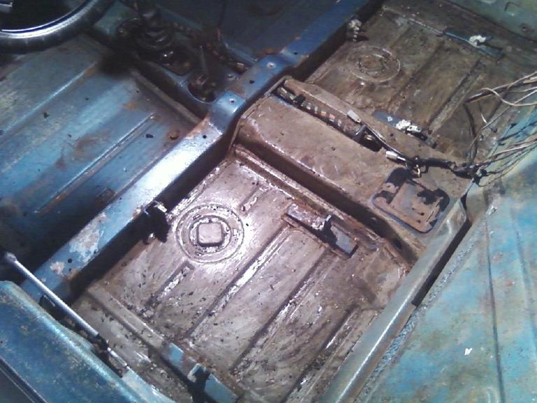

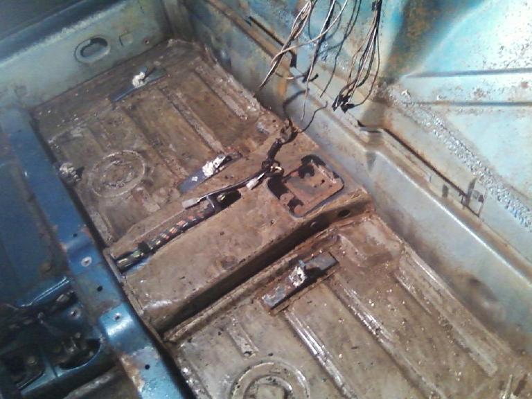

jsayre914   I didnt get very far, but i started yesterday. I g...   Aug 18 2010, 12:49 PM
jsayre914   trunk pics :)   Aug 18 2010, 12:52 PM
McMark   I've used all those products. The Spectrum Sl...   Aug 18 2010, 01:30 PM
jsayre914   cool video, thanks. I will not be using spectrum o...   Aug 18 2010, 06:06 PM
Vacca Rabite   When I did mine, this is how I did it. I wire bru...   Aug 18 2010, 06:21 PM
scotty b   IMHO you should remove the factory tar boards and ...   Aug 18 2010, 06:25 PM
jsayre914   IMHO you should remove the factory tar boards and...   Aug 18 2010, 09:04 PM
McMark   The 'tar boards' are on the floor pan and ...   Aug 19 2010, 11:32 AM
SirAndy   The 'tar boards' are on the floor pan and...   Aug 19 2010, 11:44 AM
SirAndy   Btw. the tar comes off in fairly large chunks if y...   Aug 19 2010, 11:51 AM
SirAndy   After tar removal: http://www.914world.com/bbs2/u...   Aug 19 2010, 11:52 AM
jsayre914   :toke: so what you guys are telling me is that wha...   Aug 19 2010, 12:42 PM

SirAndy   In looking at the pictures, it looks like the tar ...   Aug 19 2010, 04:21 PM

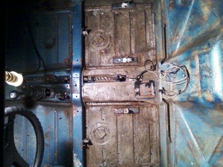

jsayre914   I have been really busy, recently, no time to work...   Aug 25 2010, 02:36 PM
jsayre914   this is where i stopped..   Aug 25 2010, 02:38 PM
jpnovak   You are using the slow method. Here is my metho...   Aug 25 2010, 02:43 PM

jsayre914   Tar is gone :Qarl: :Qarl: Now what is my next ...   Aug 26 2010, 10:27 AM
