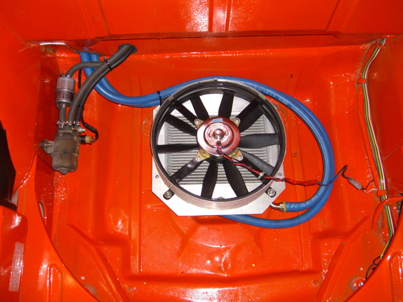

I had a mocal sandwich adapter on my racecar....with integrated t-stat.
ran the oil lines to the front trunk with a 25 row oil cooler and a large electric fan....work great and never had heating problems...fan was hooked up to my foglight switch... (no fog lights on racecar (IMG:style_emoticons/default/smile.gif))
I will eventually mount a cooler in the rear somewhere on my current '75. Probably will do another sandwich adapter with integrated t-stat. some sort of fan on the cooler for stop and go traffic, since this is my DD. (IMG:style_emoticons/default/biggrin.gif)
