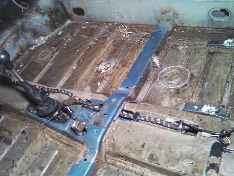

Tar is gone
(IMG:style_emoticons/default/piratenanner.gif) (IMG:style_emoticons/default/piratenanner.gif)
Now what is my next step. I guess i need to wire brush everything, then vacume, then i am ready for the por-15 ?? am i skipping any steps??
And i am having a problem removing the pedal cluster. I got the accelerator out no problem, then the 2 bottom nuts on the cluster no problem. BUT, the 2 bolts on the firewall are soooo rusted, they are no longer 13mm, in fact they arent even octagonal shaped anymore (IMG:style_emoticons/default/sad.gif)
how do i get it out of there, the bolts are also recessed with the lip of the cluster stopping any chance of getting a tool in there (IMG:style_emoticons/default/WTF.gif)

jsayre914   Tar is gone :Qarl: :Qarl: Now what is my next ...   Aug 26 2010, 10:27 AM
jsayre914   THE UGLY :sick:   Aug 26 2010, 10:29 AM
Vacca Rabite   The bolts that point forwards are, I think, welded...   Aug 26 2010, 10:52 AM
jsayre914   The bolts that point forwards are, I think, welde...   Aug 26 2010, 11:00 AM
Vacca Rabite   The bolts that point forwards are, I think, weld...   Aug 26 2010, 11:40 AM
