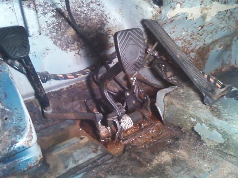

jsayre914   Tar is gone :Qarl: :Qarl: Now what is my next ...   Aug 26 2010, 10:27 AM
jsayre914   THE UGLY :sick:   Aug 26 2010, 10:29 AM
Vacca Rabite   The bolts that point forwards are, I think, welded...   Aug 26 2010, 10:52 AM
jsayre914   The bolts that point forwards are, I think, welde...   Aug 26 2010, 11:00 AM
Vacca Rabite   The bolts that point forwards are, I think, weld...   Aug 26 2010, 11:40 AM
charliew   If that car has been up north it's whole life ...   Aug 26 2010, 11:15 AM
realred914   If that car has been up north it's whole life...   Sep 4 2010, 12:52 PM
Bleyseng   If that car has been up north it's whole lif...   Sep 4 2010, 01:00 PM
