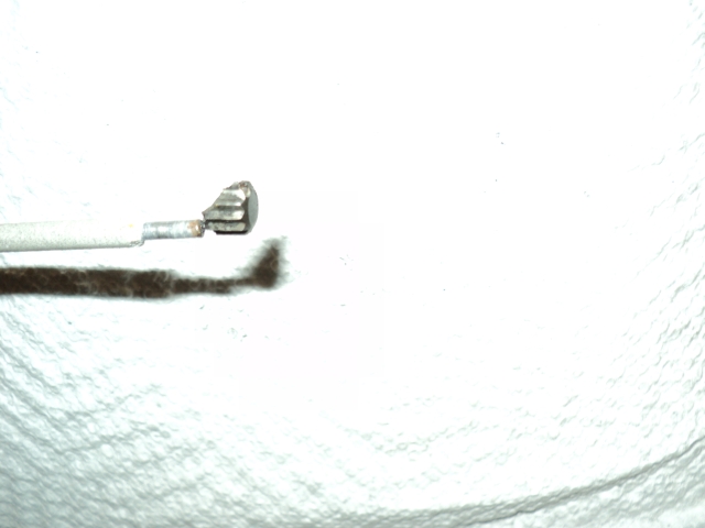

I didn't know where to put this post. I guess it's kind of a welding post. Last year when I installed my axles I guess I broke a triple square off in one of the bolts. It was on the outboard side of course. I already had my engine out and couldn't find my big socket to remove the axle nut. I don't remember breaking it but there it was. (IMG:style_emoticons/default/dry.gif)
I could wiggle the little sucker but couldn't get it out. Tried a dental pick...nope. (IMG:style_emoticons/default/idea.gif) Tried a magnet..Nope. (IMG:style_emoticons/default/idea.gif)
Ok, last ditch effort. I drug out the old buzz box, removed the flux off of the end of a welding rod to insure it would stick and not actually weld, turned the machine way down, took aim, and..... GOTCHA!
