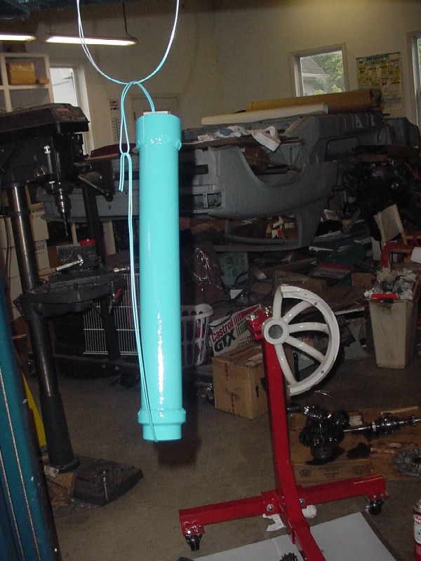

First pic shows:
914 Rotisserie
Engine stand
My really really deep socket for torquing the nut on the mainshaft of a 915 trans.

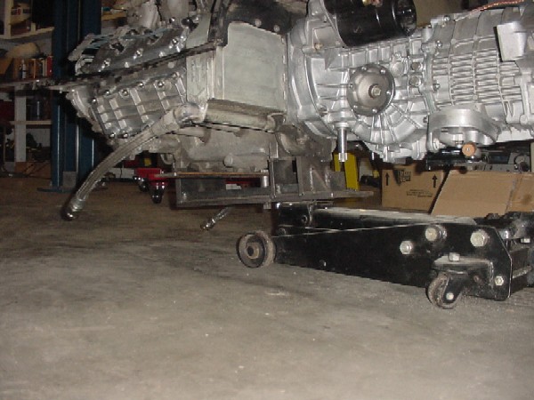

Second pic shows:
My engine support to fit my jack.
When the jack dies, I grind off the receiver pin and weld a new one to accept the new jack..... The engine and transmission are stable on this. I can also remove the trans and it remains stable enough to remove the flywheel without fear of it tipping or rolling over.
