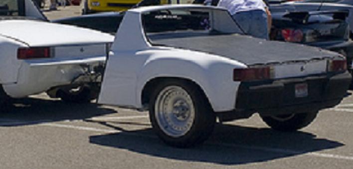

(IMG:style_emoticons/default/aktion035.gif) So I'm committed to get this dream of mine on the road
Turn this rear half of a 914 into a car-b-q (IMG:style_emoticons/default/happy11.gif)
In time to use at RedRock's Bar-B-Q
What kept me from getting it done, funds (IMG:style_emoticons/default/sad.gif)
Brutal year, but that won't stop this Stubbord Irishman
so any of the gang in Colorado has materials I can use for the car-b-q
please LMK
also a hand would be very greatly appreciated! (IMG:style_emoticons/default/aktion035.gif)
biggest issue is the propane gas plumbing
I've a great start from a fellow 914'ner
In HIS 914! (IMG:style_emoticons/default/aktion035.gif) Too kool.
He brought a 2" tube bar,3 'long for the tongue
Anybody have a 2" ball reciever?
Input please, I'm smart enough to learn from other people mistakes! (IMG:style_emoticons/default/smash.gif)

Looks like this one went through the bumper with a fold down license plate.

Sleepin   Well it was an early car! Not very aerodynami...   Aug 11 2010, 08:31 PM

Elliot Cannon   Or you could use an actual car. It looks like thi...   Aug 11 2010, 09:01 PM
majkos   I admit, engine grill for grilling would be too ko...   Aug 11 2010, 09:18 PM

Sleepin   I would think to either make the trunk lid removea...   Aug 11 2010, 09:27 PM

majkos   Alum. skin mock up   Aug 11 2010, 09:36 PM
majkos   Plenty of room   Aug 11 2010, 09:38 PM

majkos   The latest,   Aug 22 2010, 09:10 PM
majkos   another use,   Aug 22 2010, 09:11 PM
majkos   The "engine" compartment :D   Aug 22 2010, 09:23 PM

majkos   Picked up this nifty grill :headbanger: I call...   Aug 28 2010, 02:18 PM
majkos   DECONSRUCTION TIME!! :sawzall:   Aug 28 2010, 02:19 PM

majkos   We have FIRE >:D   Aug 28 2010, 07:36 PM
majkos   Fire!   Aug 28 2010, 07:37 PM
majkos   And too think I was worried it too small   Aug 28 2010, 07:44 PM
Sleepin   Don't forget the hole in the bottom so the gre...   Aug 28 2010, 08:56 PM
