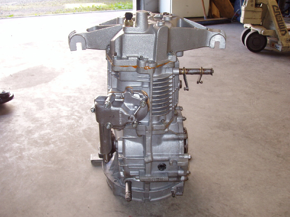

Hi together,
here´s a picture of a 915 we made a revision and converted to 916. It´s for a 914/6 with a 3.2 engine.

bugat5speed   Hi together, here´s a picture of a 915 we made a...   Aug 30 2010, 07:15 AM
