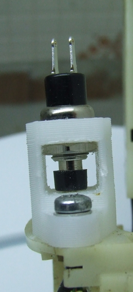

I developed a holder for a switch to replace the valve. That way you could use a pump, and eliminate a fluid line from coming into the cabin.
I like that piece. I was thinking the same thing IF i ever get around to doing the conversion. Got prints? or do you sell the piece? looks like you did it on a 3D printer, I have access to one...
Yes, I can sell a kit.
