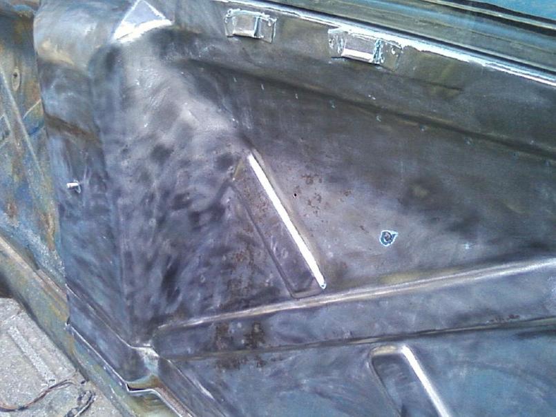

jsayre914   I have been really busy, recently, no time to work...   Aug 25 2010, 02:36 PM
jsayre914   this is where i stopped..   Aug 25 2010, 02:38 PM
jpnovak   You are using the slow method. Here is my metho...   Aug 25 2010, 02:43 PM
markb   Even easier: dry ice. Drop it on there, stand ba...   Aug 25 2010, 03:20 PM
Vacca Rabite   I don't think Joe wants the undercoating off t...   Aug 25 2010, 06:04 PM
jsayre914   Tar is gone :Qarl: :Qarl: Now what is my next ...   Aug 26 2010, 10:27 AM
jsayre914   THE UGLY :sick:   Aug 26 2010, 10:29 AM
Vacca Rabite   The bolts that point forwards are, I think, welded...   Aug 26 2010, 10:52 AM
jsayre914   The bolts that point forwards are, I think, welde...   Aug 26 2010, 11:00 AM
Vacca Rabite   The bolts that point forwards are, I think, weld...   Aug 26 2010, 11:40 AM

jsayre914   any tips or tricks on installing the sound mat. I ...   Sep 29 2010, 04:32 PM
sean_v8_914   I am not familiar with the sound deadening you are...   Sep 29 2010, 10:01 PM
jsayre914   the stuff i used said to keep all surfaces wet for...   Sep 29 2010, 10:07 PM
