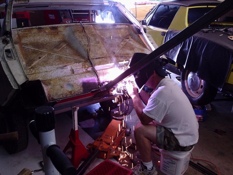

majkos   :sawzall: :welder:   Sep 6 2010, 08:24 AM
majkos   cutting the table top I said.......   Sep 6 2010, 08:35 AM
majkos   "DON'T CUT THE TONGUE OFF" :sawzal...   Sep 6 2010, 08:37 AM
RJMII   "DON'T CUT THE TONGUE OFF" :sawza...   Sep 6 2010, 08:43 AM
majkos   She has her own set of jackstands   Sep 6 2010, 08:39 AM
majkos   after we finish mock up table (Needs welding and g...   Sep 6 2010, 08:44 AM
majkos   Many hours later good used turn signal lever elem...   Sep 6 2010, 08:50 AM
