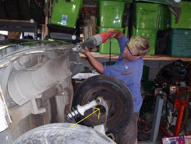

majkos   DECONSRUCTION TIME!! :sawzall:   Aug 28 2010, 02:19 PM

majkos   Getting rid of weight!   Aug 30 2010, 07:21 AM
AZ914   Looks great Kevin! :Qarl:   Aug 30 2010, 08:06 AM
Sleepin   Good use for KYBs ...now our steaks will be tender...   Aug 30 2010, 12:37 PM
majkos   Yeah I'm a sucker to throw anything away Dam ...   Aug 30 2010, 05:18 PM

Dr Evil   Great project, Kev. One word of advise, you need...   Sep 4 2010, 04:51 PM
majkos   OH REALLY!? Thanks! :WTF: More weight,...   Sep 4 2010, 08:51 PM
