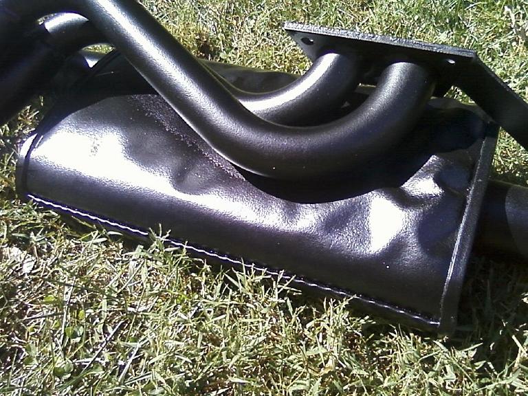

if you were following my exhaust leak thread, i purchased a brand new bursch and hooked it up to my stainless heats drove the krap out of the car, drove every day in the rain sleet snow 105 degree weather etc. pulled the motor and dropped the next motor in and drove the crap out of it some more. Then i noticed a hole the size of a softball in the muffler and the pipes are all corroded to hell. In 1 year (IMG:style_emoticons/default/confused24.gif)
So when i purchase a new bursch and it looks oh so bueatifull on day one. We all know the paint comes off on day 5. Then one month it is solid brown color. and 1 year later it is trash (IMG:style_emoticons/default/sad.gif) (IMG:style_emoticons/default/screwy.gif) What can i do to the exhaust before i install?? powder coat ceramic coat high heat paint etc. (IMG:style_emoticons/default/popcorn[1].gif) |

I waited another 2 weeks and picked up my Bursch today from the guy. He ruined my exhaust 100%. He said when the oven got to 600 degrees the metal wrinkled (IMG:style_emoticons/default/WTF.gif) I do not believe much of anything this guy says (IMG:style_emoticons/default/mad.gif) and I now have a brand new Bursch coated with ceramic (so he says). I am not sure how it will sound, or if it will even work as a muffler at all (IMG:style_emoticons/default/confused24.gif) I am also not so sure the paint wont just cook off and i am left with nothing (IMG:style_emoticons/default/ar15.gif) (IMG:style_emoticons/default/blowup.gif) I would love some opinions or comments. (so much for my new Bursch) (IMG:style_emoticons/default/hissyfit.gif) oh yeah... he said the floor of the kiln also looks like my muffler and he now has to replace the floor. This guy has no idea what he is doing. uggggg Attached image(s)

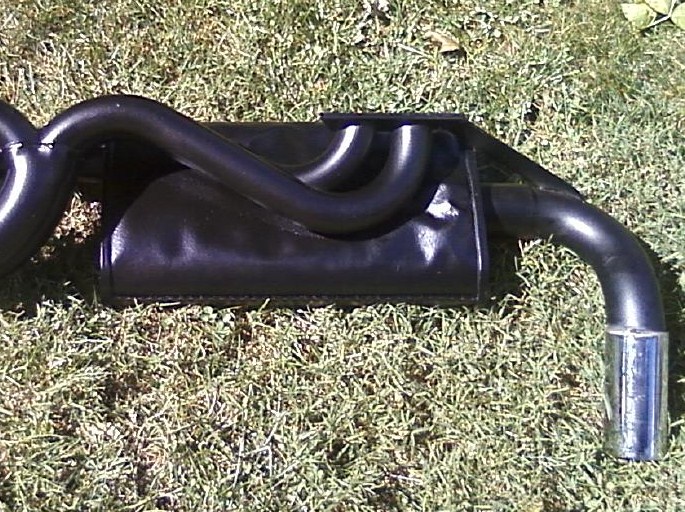

jsayre914 I just got my exhaust back from the powdercoater :... Aug 7 2010, 06:33 PM

jsayre914 here it is powdered and ready..... :beer3: Aug 7 2010, 06:33 PM
Vacca Rabite Looks bitch'n.
Let us know how the high temp ... Aug 7 2010, 08:52 PM

jsayre914 isnt it beuatiful :wub: :sick: Sep 7 2010, 10:02 AM
Vacca Rabite Joe, take a sharp knife - like an exacto knife - a... Sep 7 2010, 10:51 AM

DanT looks like the metal is deformed to me....look at ... Sep 7 2010, 12:18 PM
jsayre914 I just got off the phone with Doug at Horespower E... Sep 7 2010, 02:32 PM

Update: I just got the call today that my... Oct 21 2010, 04:29 PM

jsayre914 :Qarl: :Qarl: :Qarl: :Qarl: :Qarl: :Qarl: :Q... Oct 27 2010, 03:51 PM
dlee6204 That looks good! Looks stealthy with that bla... Oct 27 2010, 03:56 PM
Vacca Rabite That looks fantastic Joe.
