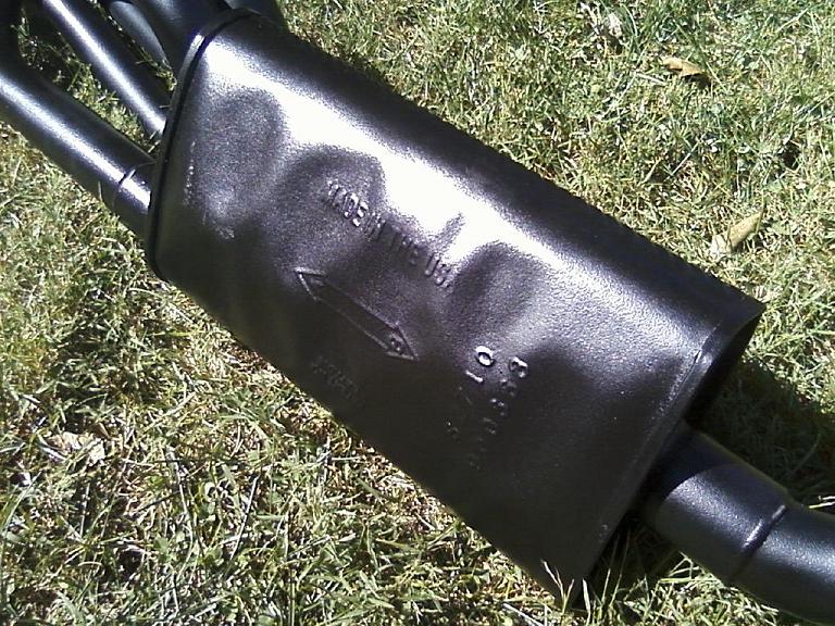

jsayre914 :( Here you go.
This brand new Bursch exhaust f... Aug 9 2010, 09:45 AM
kenshapiro2002 Think it contracted herpes.
:( Here you go. ... Aug 9 2010, 09:48 AM

This brand new Bursch exhaust ... Aug 9 2010, 09:53 AM

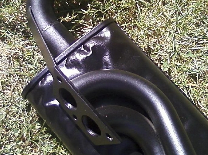

jsayre914 So.... :(
I waited another 2 weeks and picked up... Sep 7 2010, 10:01 AM
Vacca Rabite Joe, take a sharp knife - like an exacto knife - a... Sep 7 2010, 10:51 AM

is the metal actually dented?
Yup! reeee... Sep 7 2010, 12:48 PM
DanT looks like the metal is deformed to me....look at ... Sep 7 2010, 12:18 PM
jsayre914 I just got off the phone with Doug at Horespower E... Sep 7 2010, 02:32 PM
