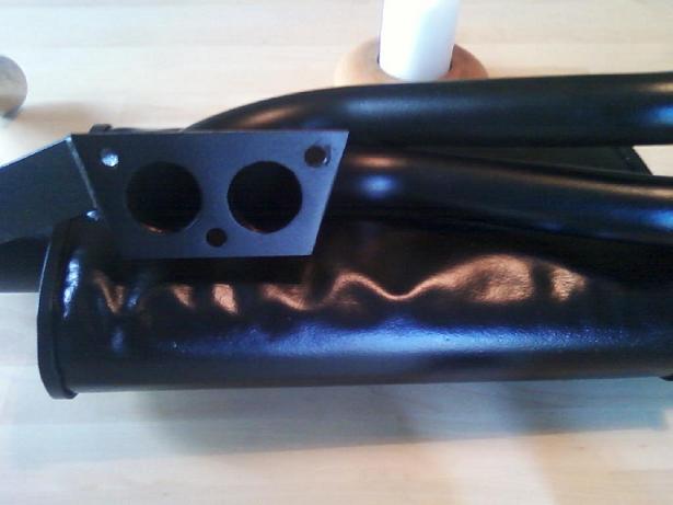

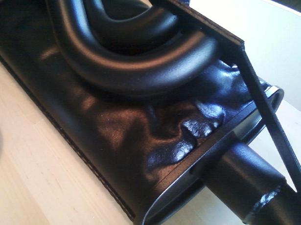

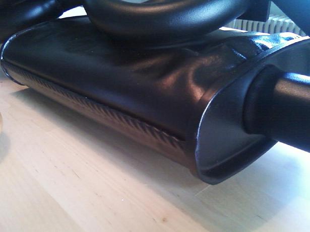

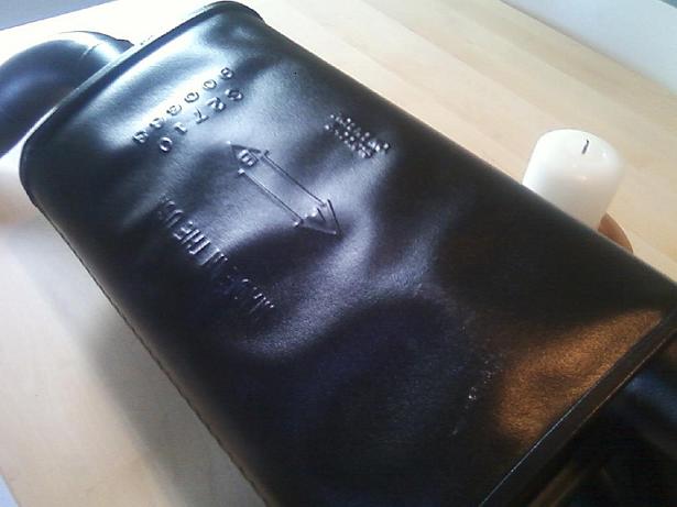

Joe, take a sharp knife - like an exacto knife - and cut one of those puckers. That looks like like the ceramic coat is blistered, and not that the metal is actually dented.
But I could be seeing something wrong. is the metal actually dented? If so, I think that your guy did something horribly wrong. That muffler can take temps well over 600 degrees without deforming. I am guessing that this guy cranked the oven to its hottest possible temp and just left it in there. If it were me, I'd be asking for a full refund for the work done AND for the cost of a new muffler, with a threat of taking Douchy McPowdercoater to civil court. if you know any lawyers, get one to write you a letter as ammunition. You have been robbed, my friend. Zach |

is the metal actually dented? Yup! reeeeal bad (IMG:style_emoticons/default/sad.gif) I could rename this thread, "How to kill a Brand new Bursch Muffler" Attached image(s)
