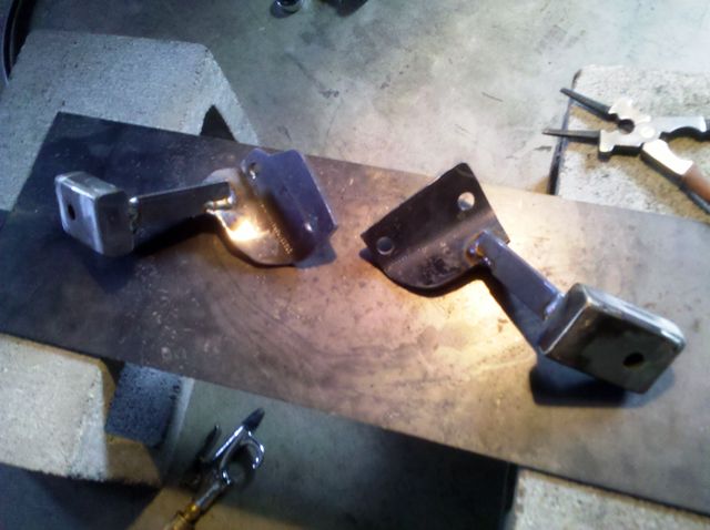

After studying some online pics of some Suby trans mounts, I gave it another try.
I followed the advise of other Conversionites (IMG:style_emoticons/default/beer.gif) and used 911 sports mounts to attach the Suby trans to after fixing it with hard mounts.
The pics will say it better... Sorry for the blurriness, camera phone pics.
1 inch tubing that is boxed and sleeved for the bolt (prevent crushing)
attatched with 1"x1"x.25" angle steel to a .25" plate cut to fit the Suby case
Suby mounts version 2.0

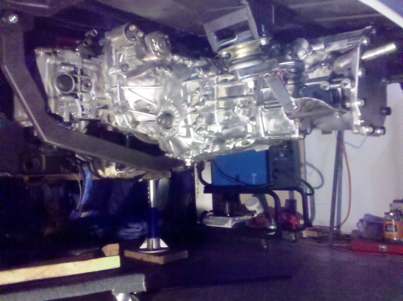

Zaney   Alrighty then! More progress on the Suby Trans...   Jul 20 2010, 01:57 PM
Zaney   Here is my attempt at the Suby Transmission mount ...   Jul 20 2010, 02:04 PM
Zaney   Here is the alignment of the axle for the Suby Tra...   Jul 20 2010, 02:09 PM
Zaney   There is plenty of room in the engine bay with thi...   Jul 20 2010, 02:13 PM

Zaney   I am actually in the redesigning phase of my trans...   Aug 26 2010, 12:02 AM
charliew   I think you will find that unless you brace the mo...   Aug 26 2010, 02:16 PM
Zaney   After studying some online pics of some Suby trans...   Sep 10 2010, 01:29 PM
Zaney   The main reason for the new mounts was to provide ...   Sep 10 2010, 01:36 PM
