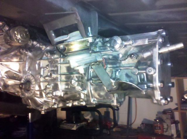

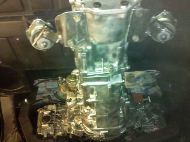

The main reason for the new mounts was to provide clearance for any obstacles that the rear of the car might encounter (ie. speedbumps)
I will see how the forward and rear sway of this system is effected by the acceleration and braking of the car. It was suggested to join the engine and trans mounts to provide more stability. I will watch this when I get it on the road and go from there.

Zaney   The main reason for the new mounts was to provide ...   Sep 10 2010, 01:36 PM
