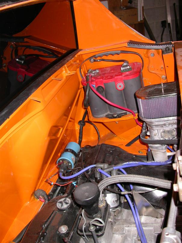

sean_v8_914   perhaps I should post some finished product instre...   Sep 13 2010, 07:59 AM
sean_v8_914   or this clean...   Sep 13 2010, 08:04 AM
sean_v8_914   1911cc l-jet   Sep 13 2010, 08:05 AM
sean_v8_914   I love Adriatic blue. ps. I didnt do that run...   Sep 13 2010, 08:09 AM
