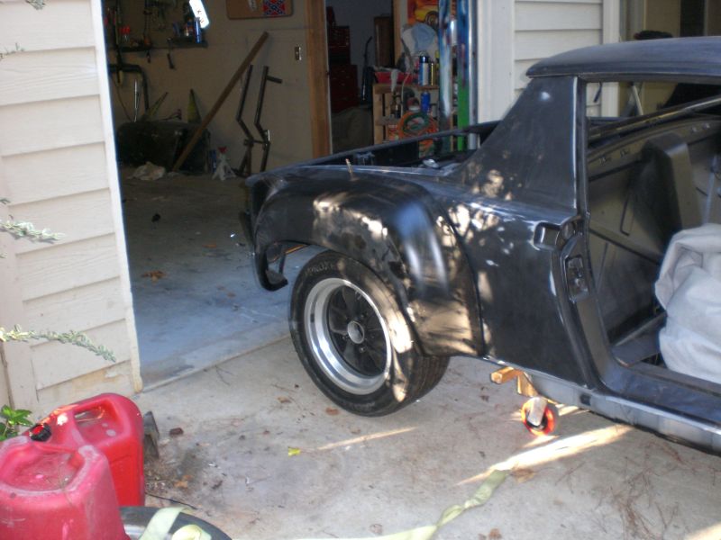

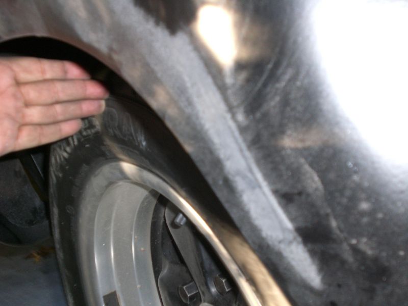

ok its been awhile....Test drove Bob's car....its true its true!!! The suby tranny with a cable shifter is a sheer hoot....
Ok I have been doing small stuff and hunting down hardware after 4 years!! Can you explain how the tie down clamp for the front strut ended up in my bathroom!!!!
I but steering rack together and trial fit the front end. I also trial fit the rear swing arms so I could mount some tires!!
Slowly but surely tracking down all of the hardware.. Those flairs just ate up my eights!!
