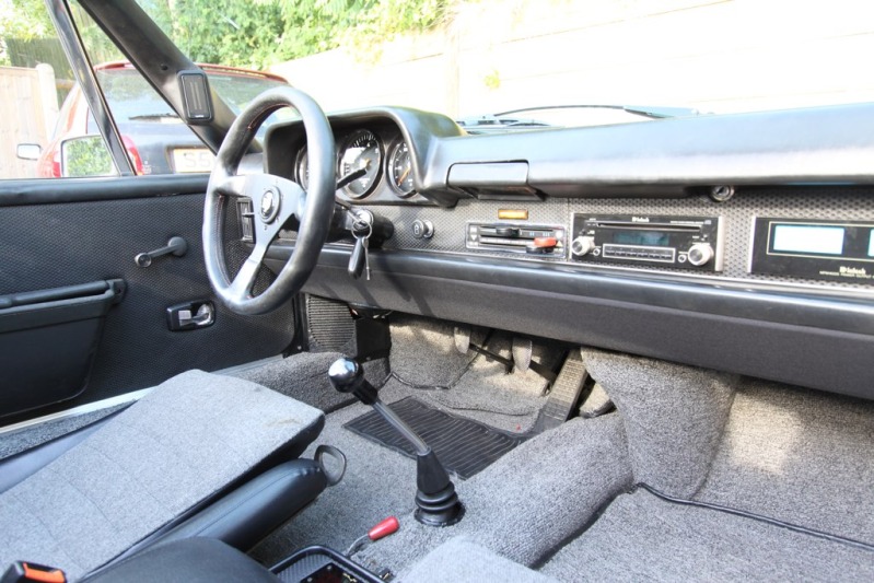

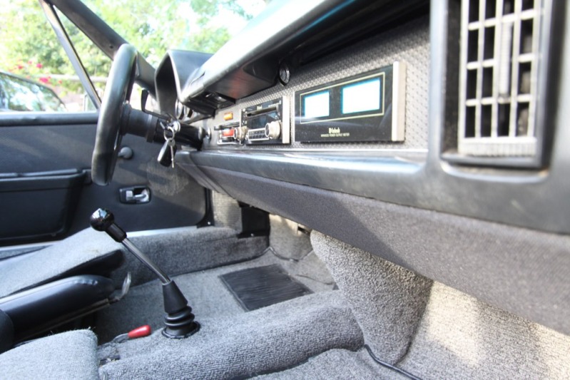

I Finished the interior today (IMG:style_emoticons/default/piratenanner.gif) New carpet set went in which I ordered from appearance and performance, I also ordered some extra material so I could cover my sub box.
I'm running some pretty esoteric equipment in this 914, McIntosh MX406 & MPM4000 built int the dash (I deleted the glovebox and built an aluminium panel to hold the HU & meters. The amp is a Mcintosh MC4000M - The mother of all SQ car amps... The sub is a CDT 8" SQ sub, I managed to squeeze a 9 litre enclosure into the footwell. the sub faces up at the dash, rather than be kicked by the passengers..

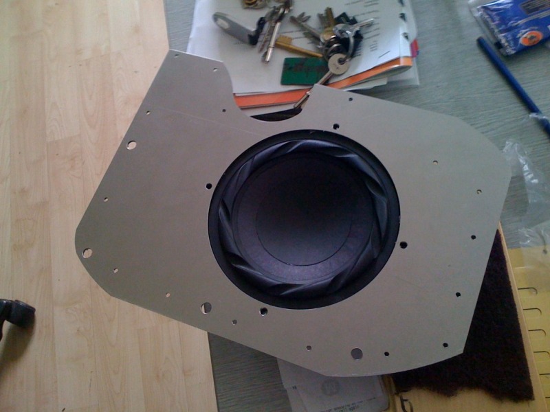

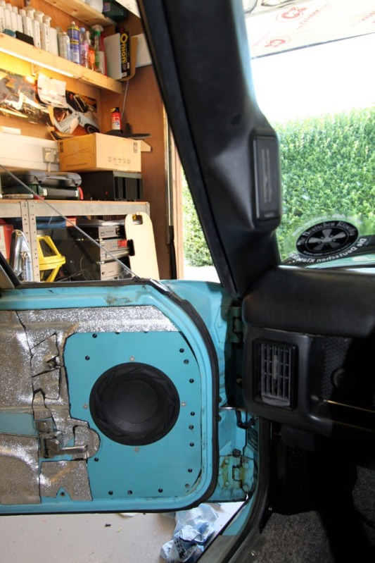

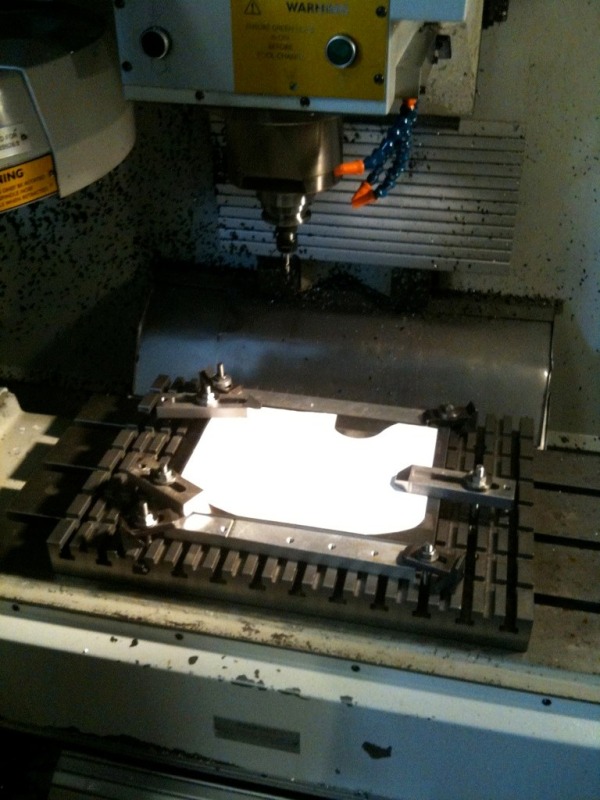

So I had heavily modified morph speaker builds in and loved thise for a while, but wanted to try something different, so I wanted to put some speakers in the doors and tweeters on the A pillars and horns under the dash - not an easy task.

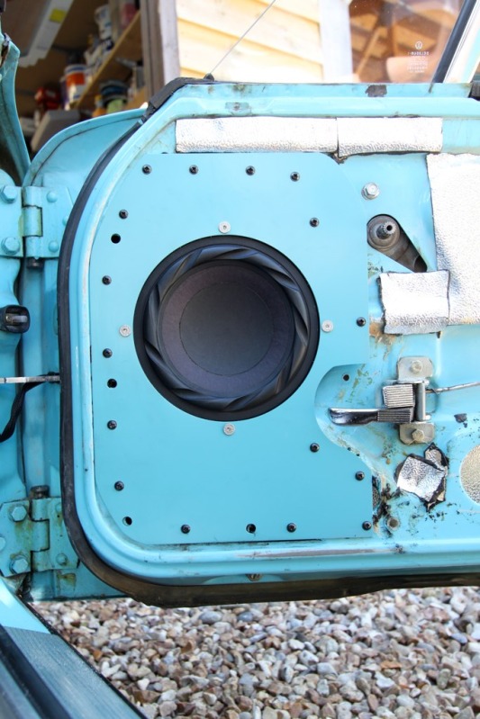

I didn't want the doors to rattle at all, so I deadened the hell out of them and then cnc'd up a 4mm steel panel which is bolted to the door and the speaker is bolted to that..
(IMG:http://www.914world.com/bbs2/uploads_offsite/i62.photobucket.com-8526-1284911348.1.jpg)

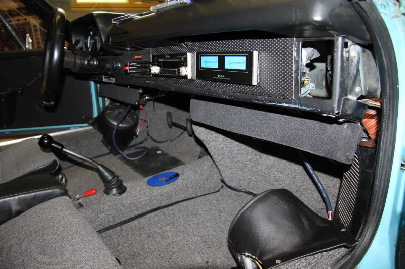

Then the horns - These fit under the dash and sound best as far back as possible, so remove the lower dash pad and fit horns to metalwork..
(IMG:http://www.914world.com/bbs2/uploads_offsite/i62.photobucket.com-8526-1284911356.5.jpg)
Then I stripped the lower pad and cut the lower half of the vinyl away, level with the top of the horns.. I then put a piece of speaker grill cloth from this cut - hotglued in (attached to a piece of baton the width of the car) so when stretched you literally can't see the cut/join between the two fabrics)) The grill cloth was then glued again to the underside of the horns following another piece of metal bar being ran from one side to the other to enable the grill cloth to flow smoothly. And they then look like this..
