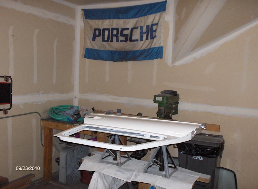

Painted the......drivers door last night. Really liking these little Prevel cans.
No, not the same quality as a true HPLV gun, but it's getting the paint on. Slow reducer and hardener continue to prove a good thing to help the paint flatten out over time.
Downside is still 4-5 coats before proper color coverage. This is my first white paint job as well. I think white is harder to cover than most other colors?
