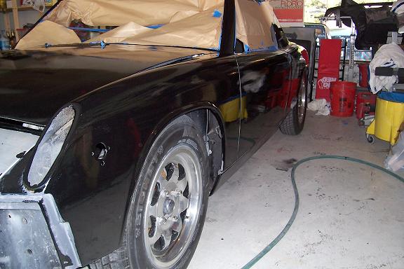

Click to view attachmentI don't have an image of kicking myself in the ass!
Honestly i ended up spraying the car for a total of under $250 in materials.
biggest problem was my wife complaining about the smell; the house is above the garage.
I opened the windows and had the air going when i sprayed.
Watered the floor too! Actual "neighbor" risk was really only for about an hour during the spraying; have to wait between coats. I did it at 10:00am on a workday.
