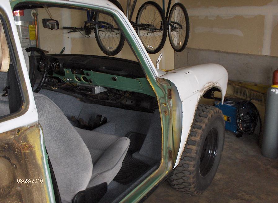

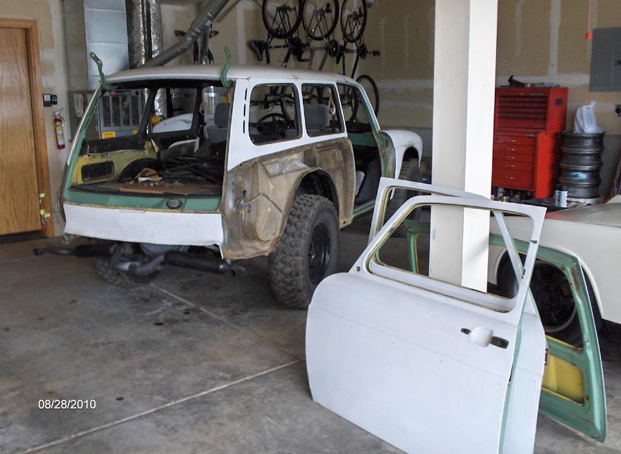

You can see there isn't any rust to speak of. I plan on painting the body first, then doors, fenders etc.
I figure if I can get the main body painted, I can put the windows back in, really clean and sort out the interior, then move onto the doors. It's gonna be a winter car, so it's gotta be sealed up.

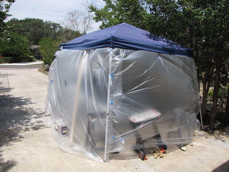

I painted a good portion of our Audi under one of those quickshade 12X12 canopies, and I used the cheap painters drop plastic for the walls. If you had two of those to put together, I think it would be a solution to paint an entire car.
http://www.uber-werks.com/albums/a4_repaint/album/index.html
(IMG:http://www.914world.com/bbs2/uploads_offsite/www.uber-werks.com-1349-1283311690.1.JPG)
