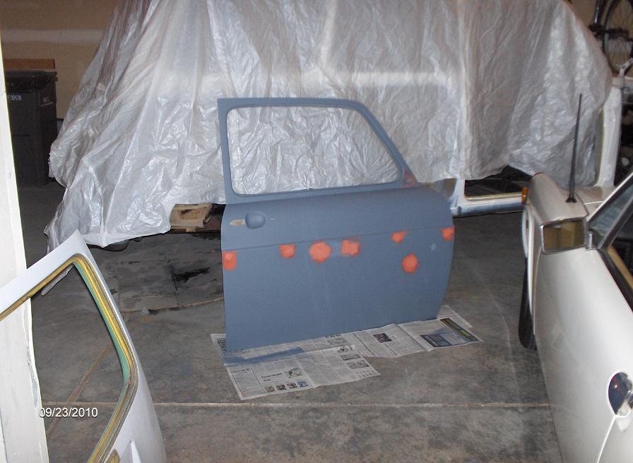

Root_Werks   Painted the......drivers door last night. Really ...   Sep 23 2010, 08:57 AM
Root_Werks   I would have painted the passenger door, but I was...   Sep 23 2010, 08:58 AM
scotty b   PLEASE tell me that isn't nitro stain............   Sep 23 2010, 06:14 PM
Root_Werks   B)-->
QUOTE(scotty b @ S...   Sep 23 2010, 08:14 PM
