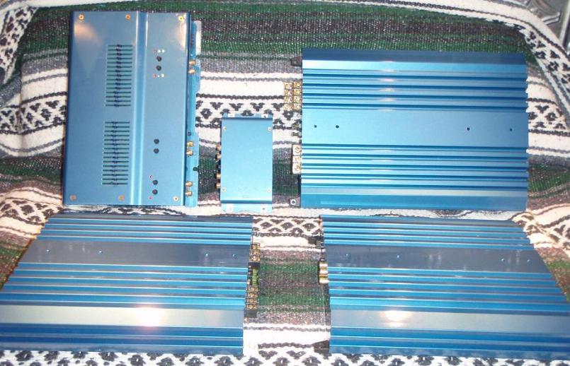

Now take your sound deadening pad and cut it into strips that fit in between the channels only. Leave the channels open, that is what f'ed up most of these floor pans. You get the amps together? (IMG:style_emoticons/default/poke.gif)
jsayre914
post Sep 29 2010, 07:14 AM
Speed Up !!!
Posts: 3,210
Joined: 10-February 08
From: Timonium MD 21093
Member No.: 8,696
QUOTE(scotty b @ Sep 29 2010, 09:01 AM) *
YUP! (IMG:style_emoticons/default/biggrin.gif)
