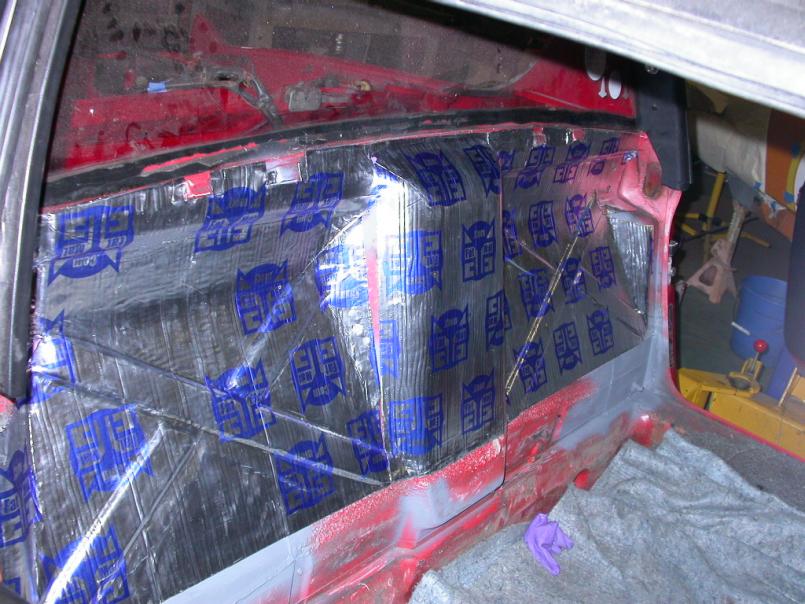

jsayre914   I didnt get very far, but i started yesterday. I g...   Aug 18 2010, 12:49 PM
jsayre914   trunk pics :)   Aug 18 2010, 12:52 PM

jsayre914   No time for pics today, but i am ready for paint. ...   Sep 28 2010, 04:02 PM
jsayre914   progress :beer3:   Sep 28 2010, 08:15 PM

jsayre914   Some work on the project yesterday :D   Oct 10 2010, 03:29 PM
jsayre914   and one picture for scotty. See, i do listen to yo...   Oct 10 2010, 03:31 PM
