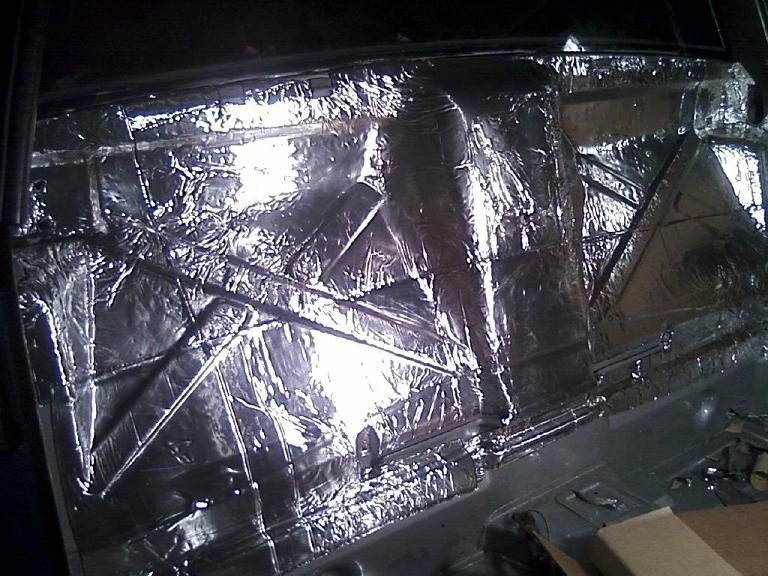

Some work on the project yesterday (IMG:style_emoticons/default/biggrin.gif)

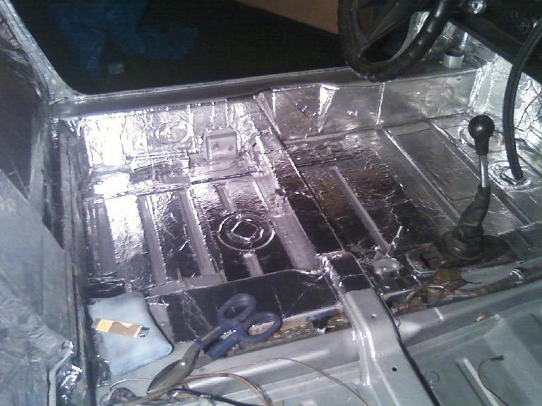

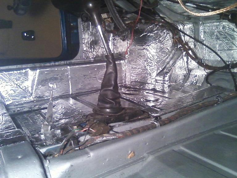

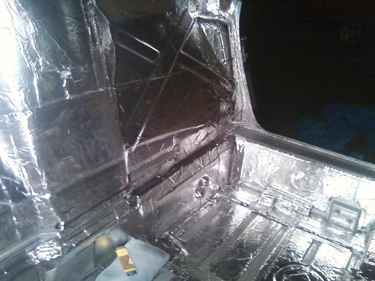

jsayre914   Some work on the project yesterday :D   Oct 10 2010, 03:29 PM
jsayre914   and one picture for scotty. See, i do listen to yo...   Oct 10 2010, 03:31 PM
