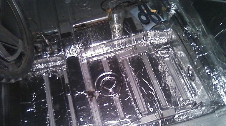

jsayre914   Some work on the project yesterday :D   Oct 10 2010, 03:29 PM
jsayre914   and one picture for scotty. See, i do listen to yo...   Oct 10 2010, 03:31 PM

SirAndy   I've been thinking about using a different app...   Oct 10 2010, 05:48 PM
Prospectfarms   I've been thinking about using a different ap...   Nov 1 2011, 08:19 AM
scotty b   You could have saved yourself so much time, aggrav...   Oct 10 2010, 05:54 PM
