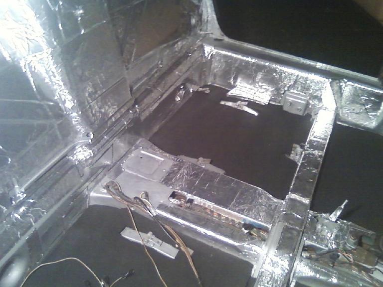

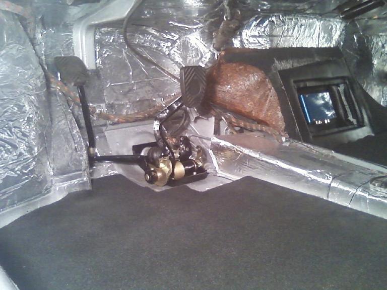

jsayre914   Some work on the project yesterday :D   Oct 10 2010, 03:29 PM

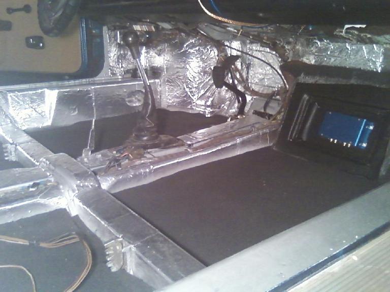

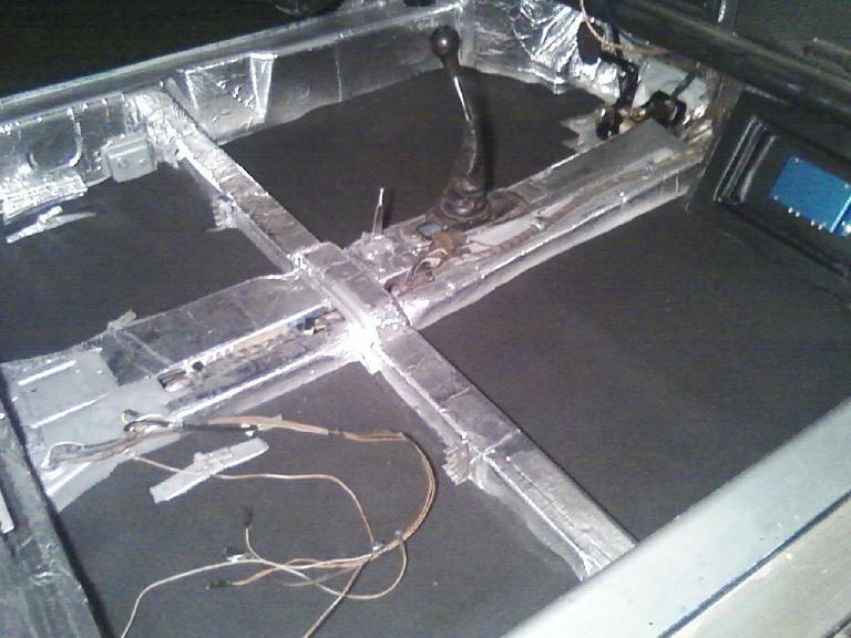

jsayre914   I put the interior back togeather last night. Man,...   Oct 27 2010, 04:05 PM
jsayre914   The carpet is from 914 apperance and performnance....   Oct 27 2010, 04:07 PM
