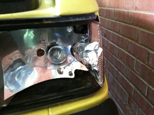

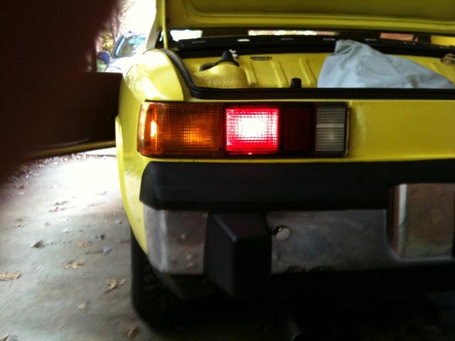

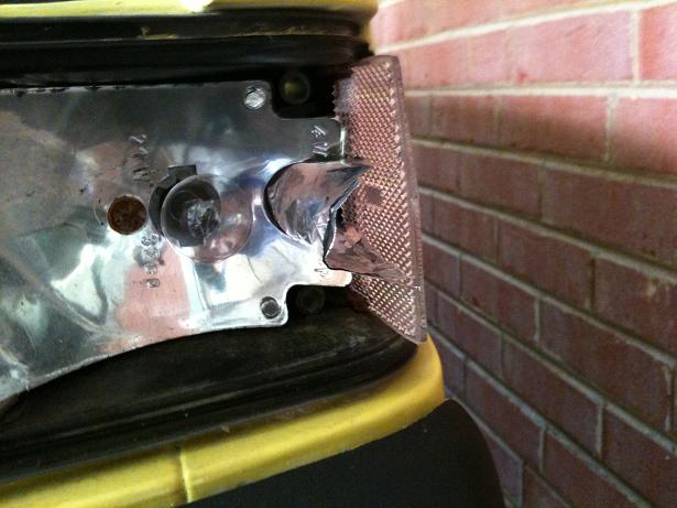

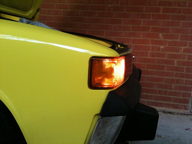

For those who are interested, I came up with a cheap fix to this problem. I took a small (doubled-over) piece of aluminum foil and shaped it around the corner marker light, so that it shines only out of the side, and doesn't illuminate the rear-facing turn signal section.
Below, illustrated via cell-phone camera.
First, curved piece of foil around the corner marker light.
Then, "close" end of of foil against side-facing reflector surface.
Result: reduced glow of turn signal when tail-lights are on (although from side view, the corner marker is amber)
And for the curious - I made sure that the turn signal, when lights are off, isn't obstructed in side view due to the foil. This is a shot of the turn signal blinking, headlights/taillights off, from side view.
