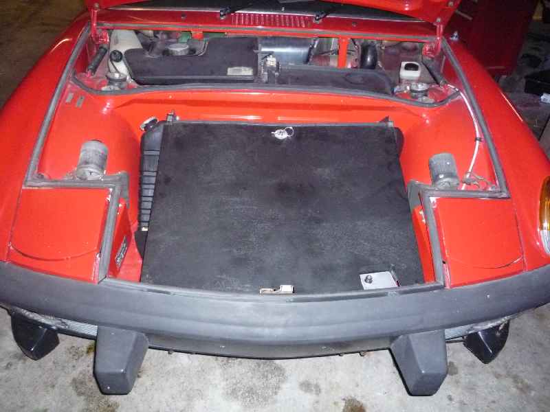

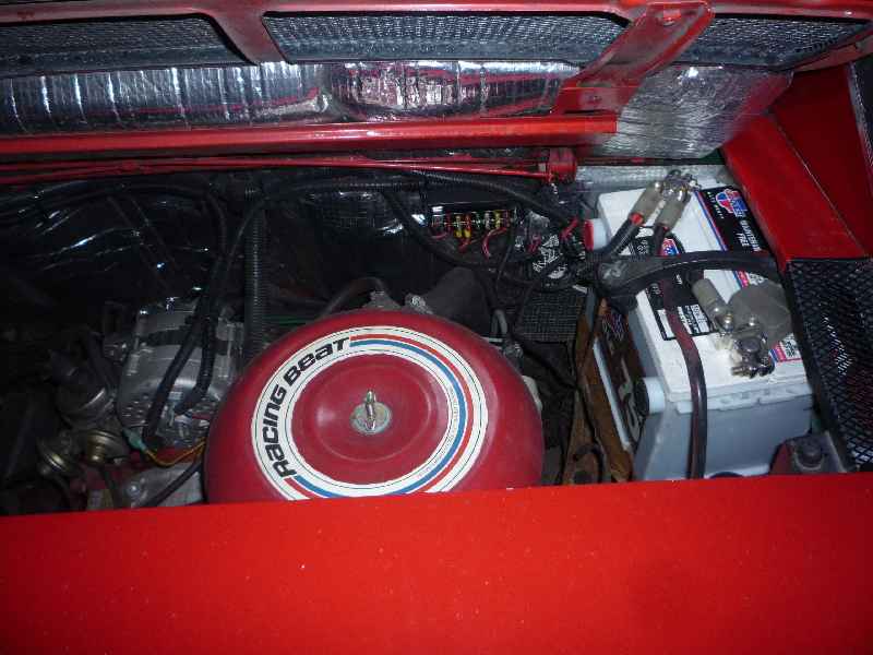

Okay so this is my latest find. This is a 74 with a 13b Rotary motor that was built by Racing Beat in CA. Looks like they were in Anneheim. Not sure if they are still around. Guy bought it in similar condition to selling it. When he bought it the motor had overheated. He took it to Racing beat & had it completely rebuilt. Said it was pushing 220hp but only got 5mpg. I know rotary's came in rx-7's for the most part. Thats about the extent of my knowledge of the rotary. The guy has had this sitting in his garage since 99 when it overheated on him. He said it won't run but will turn over. I'll get more detailed pics of the fron radiator setup with oil cooler. Take a look at the motor pics. Defintely looks to have been a pretty hot motor. Kind of figuring to go Suby with the TDI conversion as a possibility.
Anyone looking for a project I have like 3 cars I will be getting rid of (IMG:style_emoticons/default/biggrin.gif) .
Anyway take alook at the pics & let me know what you think. Paint code is l64k which is a forest green. Obviously it was repainted some shade of red/orange

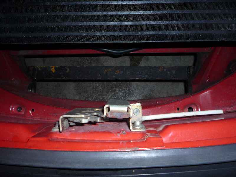

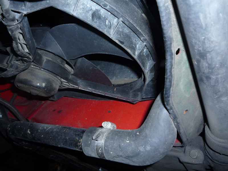

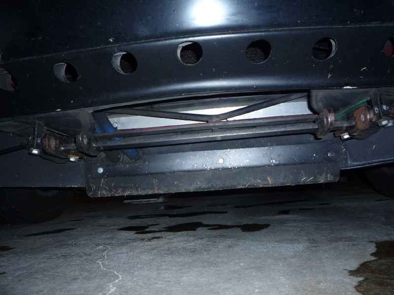

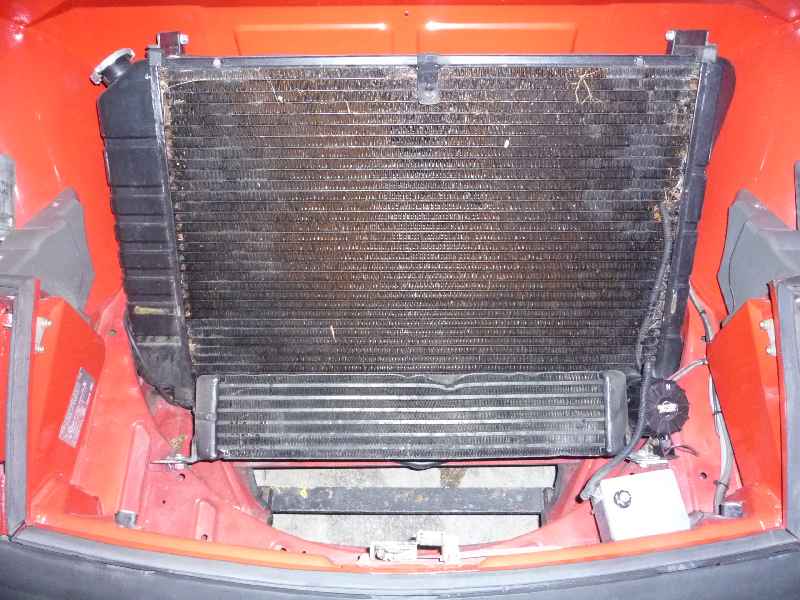

Radiator pics! Pulls in the front bottom channels it up to radiator which is angled back down & then back out the bottom? Drove it quite a while with it like this with no problems? Definately not an optimal setup but could work okay

JRust   I'm a little surprised to see dual MSD boxes i...   Oct 26 2010, 01:21 PM
Rotary'14   I'm a little surprised to see dual MSD boxes ...   Oct 26 2010, 01:29 PM
JRust   Mazda ignition system has 2 coils,, Leading and T...   Oct 26 2010, 01:58 PM

Rand   When I saw the pic of the radiator setup they used...   Oct 26 2010, 03:19 PM
JRust   I need to take pics of the radiator setup. There i...   Oct 26 2010, 03:39 PM
kg6dxn   I need to take pics of the radiator setup. There ...   Oct 26 2010, 04:39 PM
Rand   I need to take pics of the radiator setup. There ...   Oct 26 2010, 04:48 PM
JRust   I need to take pics of the radiator setup. There...   Oct 26 2010, 06:01 PM

oldschool   What are the 2 black things near the air dam?   Oct 26 2010, 08:52 PM
JRust   What are the 2 black things near the air dam? Do...   Oct 26 2010, 10:12 PM
oldschool   What are the 2 black things near the air dam? D...   Oct 26 2010, 10:38 PM
JRust   no in photo 1 next to the tits :blink: Ah sorry...   Oct 26 2010, 10:48 PM
oldschool   no in photo 1 next to the tits :blink: Ah sorr...   Oct 26 2010, 10:56 PM
JRust   Yes my last name is Rust. Ironic I know :blink: ...   Oct 26 2010, 11:14 PM

kg6dxn   Is that a heater core bolted to the engine bar?   Oct 27 2010, 10:39 AM
oldschool   Is that a heater core bolted to the engine bar? ...   Oct 27 2010, 11:02 AM
Rotary'14   Is that a heater core bolted to the engine bar? ...   Oct 27 2010, 11:37 AM
JRust   Is that a heater core bolted to the engine bar? ...   Oct 28 2010, 08:22 AM
