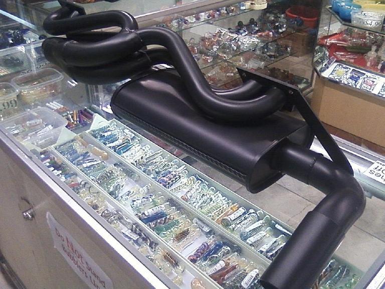

Oct 27 2010, 03:51 PM
#2
Speed Up !!! ![]() ![]() ![]() ![]() Group: Members Posts: 3,210 Joined: 10-February 08 From: Timonium MD 21093 Member No.: 8,696 Region Association: MidAtlantic Region |
(IMG:style_emoticons/default/piratenanner.gif) (IMG:style_emoticons/default/piratenanner.gif) (IMG:style_emoticons/default/piratenanner.gif) (IMG:style_emoticons/default/piratenanner.gif) (IMG:style_emoticons/default/piratenanner.gif) (IMG:style_emoticons/default/piratenanner.gif) (IMG:style_emoticons/default/piratenanner.gif) (IMG:style_emoticons/default/piratenanner.gif)
It looks great black, I love it (IMG:style_emoticons/default/biggrin.gif) Cant Wait To Get Home !! (IMG:style_emoticons/default/driving.gif) Attached image(s)
