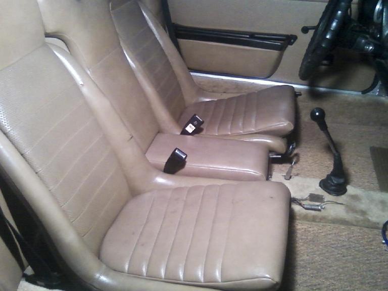

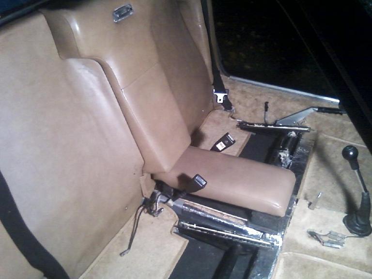

jsayre914   I put the interior back togeather last night. Man,...   Oct 27 2010, 04:05 PM
jsayre914   The carpet is from 914 apperance and performnance....   Oct 27 2010, 04:07 PM
