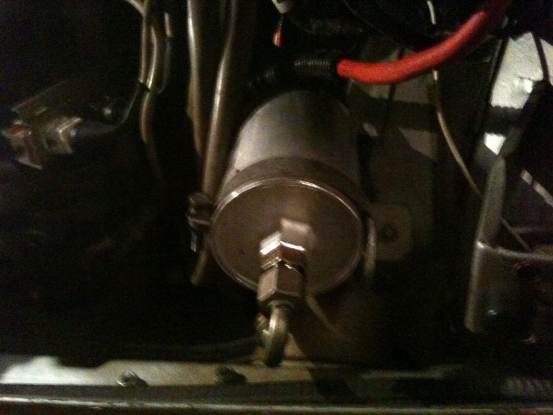

Here's some picks, but not much to see. The filter used to be strapped to the engine lid support brace but Otto's added a brace and strapped it to it.
