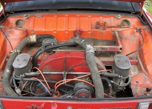

Spend $1600 on a JDM turbo rotary 13B and drop it in. You got the perfect setup. I'm thinking about a 20B Turbo (3 rotor) They are stock with 285hp and 290ft lbs. With the 20B you add a boost control, fuel mapping and exhaust and you get an easy 400hp without going too radical. You need to figure out a spot for the intercooler. You have the adapter already... about $3500 for the 20B JDM.
Or, just scrap the whole idea and do one of these bad ass conversions...

Spend $1600 on a JDM turbo rotary 13B and drop it in. You got the perfect setup. I'm thinking about a 20B Turbo (2 rotor) They are stock with 285hp and 290ft lbs. With the 20B you add a boost control, fuel mapping and exhaust and you get an easy 400hp without going too radical. You need to figure out a spot for the intercooler. You have the adapter already... about $3500 for the 20B JDM.
Holy crapola who butchered that car? (IMG:style_emoticons/default/WTF.gif)
I'm looking into rebuilding this motor first. As everything is setup for it that makes the most sense. If it will cost to much then I will consider my options for another rotary motor.
