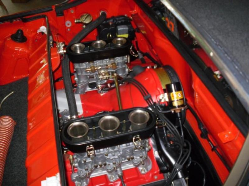

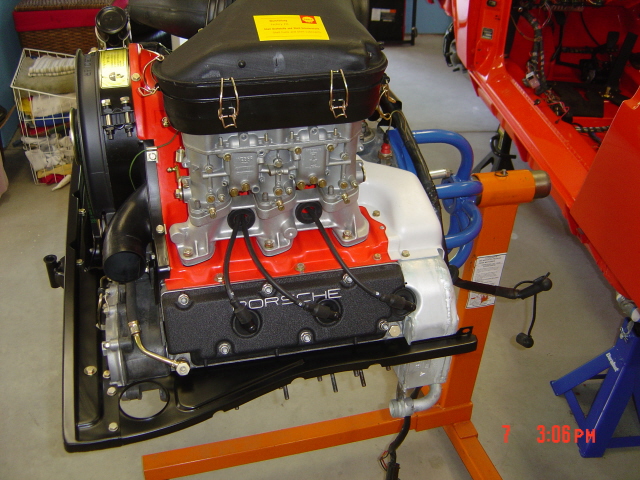

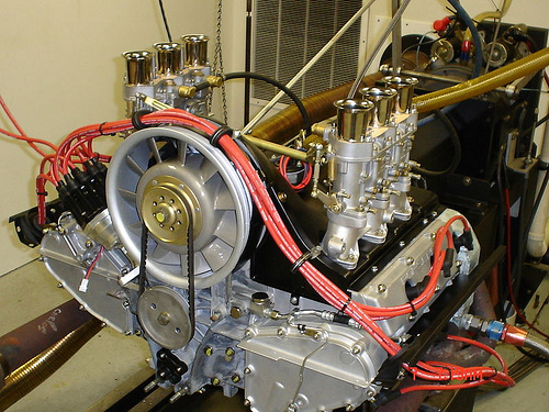

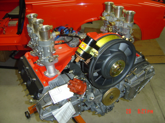

I think I'm going with carbs. For the flexibility and the simplicity.
+Simplicity: I can work on and tune carbs, a caveman could do it. I'd be totally lost with the CIS.
+Flexibility: If I take this engine apart for any reason in the future, I'd like the flexibility to change cams, compression, or even displacement. I really believe that this will simplify the conversion.
-Cost: This (conversion to carbs) is going to be expensive. I get to use my Carter fuel pump and MSD ignition, so I save money there. But I don't have to buy a CIS brain, CIS fuel pump, or CDI box, so I save money there too. Now I'm looking for carb and manifold deals. Will work for carbs.
Here are some more reasons. I want my engine to look like this. My apologies to the owners of these engines.
