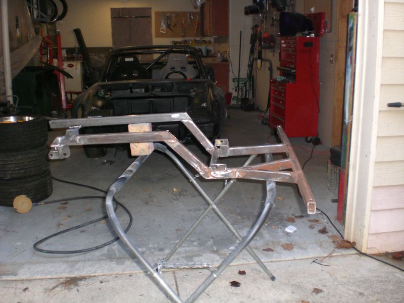

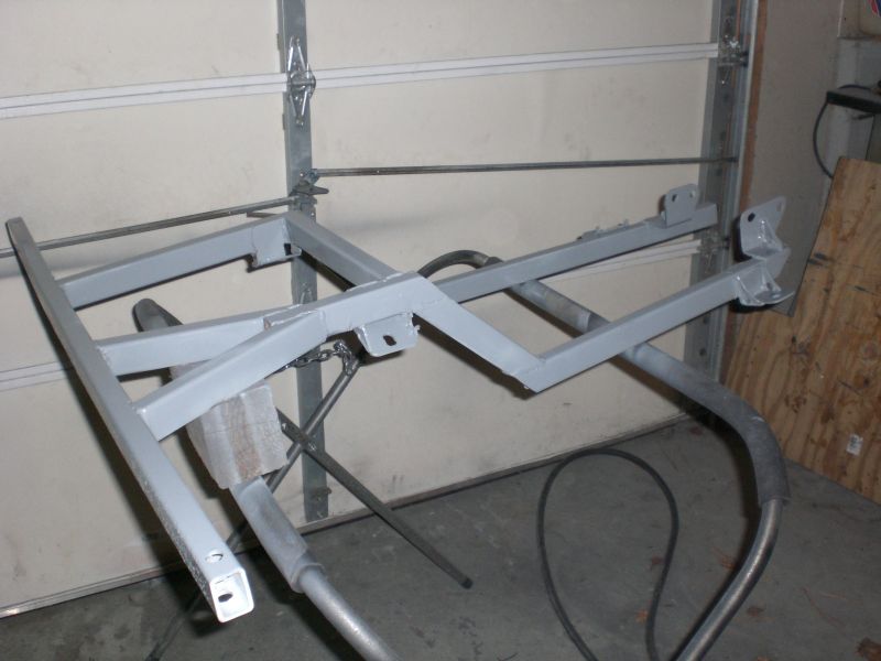

post Oct 30 2010, 05:13 PM
Posts: 2,352
Joined: 12-July 03
From: Atlanta, ga
Member No.: 904
engine bar done and being sanded and painted
upside down

Britain Smith   Do you have an pictures of your engine cradle? -B...   Oct 25 2010, 10:58 PM
d914   I will this weekend. I have to pull it, sand it am...   Oct 26 2010, 06:28 AM
d914   engine bar done and being sanded and painted ...   Oct 30 2010, 05:13 PM
