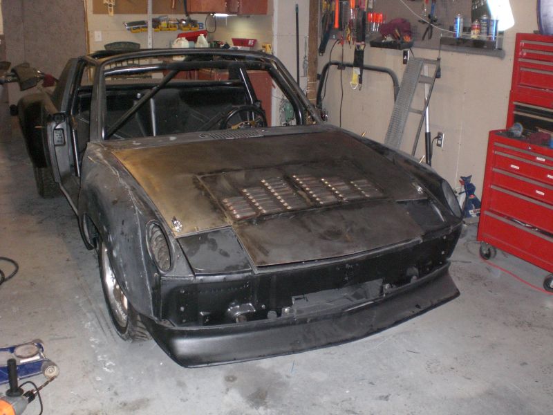

d914   my experimental hood.. Its a little wavey!...   Nov 6 2010, 07:21 PM

kg6dxn   I like the idea of your hood. I'm concerned th...   Nov 8 2010, 08:21 PM
d914   I will, but we have done some checking and over al...   Nov 8 2010, 10:34 PM
