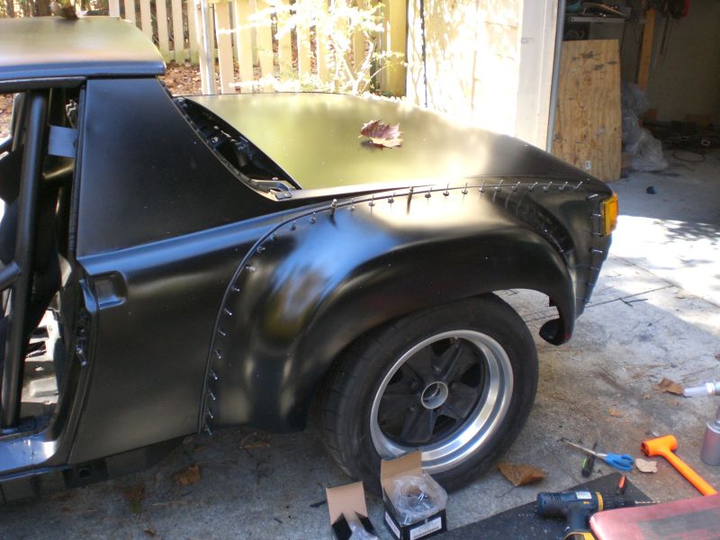

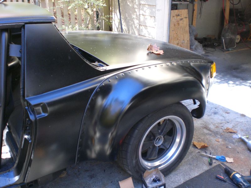

d914   painted and putting the flares on!!   Nov 13 2010, 02:25 PM
d914   one side done, came out reasonably well conciderin...   Nov 13 2010, 02:27 PM
