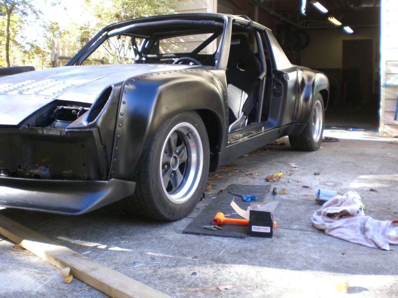

post Nov 13 2010, 02:27 PM
Posts: 2,352
Joined: 12-July 03
From: Atlanta, ga
Member No.: 904
one side done, came out reasonably well concidering who was doing the work!! (IMG:style_emoticons/default/beer.gif)

d914   painted and putting the flares on!!   Nov 13 2010, 02:25 PM
d914   one side done, came out reasonably well conciderin...   Nov 13 2010, 02:27 PM
